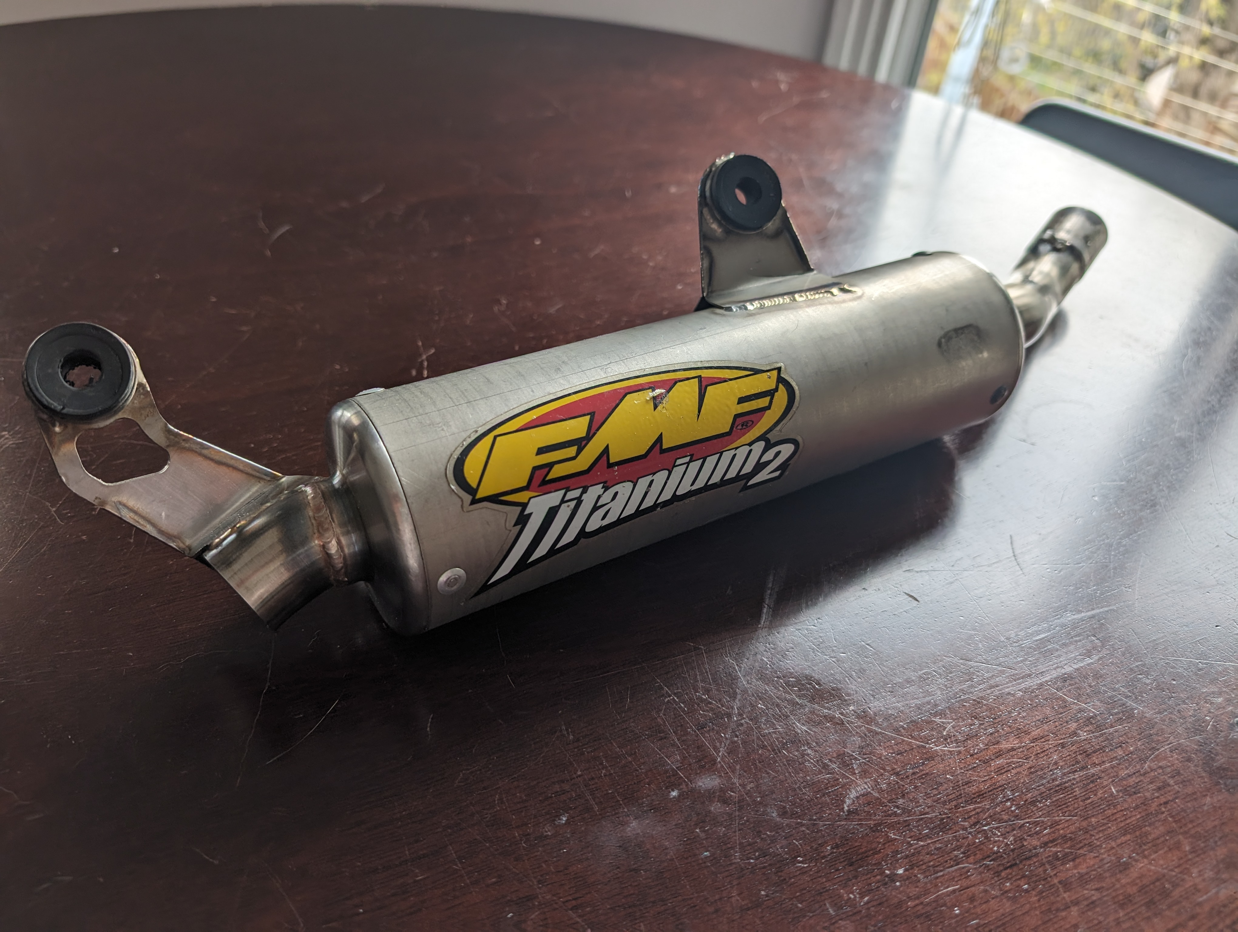

-For the time being I'll take this FMF pipe and bring it to a local plating shop to strip the nickel plating and make my own 'factory fatty'.

You can buy a raw metal fatty from FMF. People say that the nickel plated pipes crack easier. I don't know if it's true but stripping...

True, I did see that FMF had one factory fatty for this bike in stock. However, being picky as I am, I noticed it's their new generation of pipe with the logo on a flattened part of the pipe ... for the sake of 'restoring' this bike to its former glory, I think I will pick up one of the available ones on eBay that are new old stock, and don't have the flattened logo.

Repacked the silencer, it definitely needed it. [img]https://p.vitalmx.com/photos/forums/2021/06/26/499610/s1200_PXL_20210513_020337909.jpg[/img] Spent quite a while cleaning the air box, subframe, and frame (didn't remove the engine however). [img]https://p.vitalmx.com/photos/forums/2021/06/26/499611/s1200_PXL_20210512_044748397.jpg[/img] Finally...
Finally cleaned, maintained, and replaced everything that immediately needed it, and buttoned everything back up. Put some of my old # plates on it just for a track day.

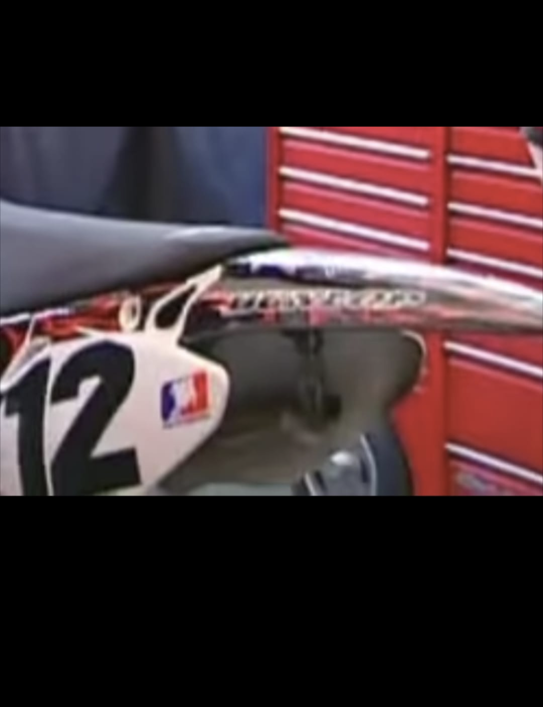

The 2 front tapped holes for the head's studs, enter the flapper valve cavity and are not sealed, OEM nuts are domed to stop leakage.

I found this close up photo (in my photobucket account) of the rear wheel taken at the Phx sx.

And finally, one of my best friends found this lost gem for me: a custom round-barrel, stinger-tip FMF Titanium II silencer, *the* silencer that was on the bike back in the 2006 race season!!
Or at least, one of the silencers. The later version Titanium 2 silencer that came with this bike was clearly one that was modified to race with as well, but in the Youtube videos I was able to spot that this bike used the stinger version the races it partook in.
That's the update for now, the bike is still apart neatly stowed in boxes. Everything has been cleaned or vapour blasted and is ready to be put back together. I am selling another one of my bikes to fund the rest of this project; still need to build the wheels from scratch and do the graphics.

That Ti-2 with the stinger is fucking bad ass! That style FMF decal brings back so much nostalgia. Sweet suspenders too!
1 day ago
Definitely looks like a PC silencer with a FMF sticker.
DV was running the exact same combo on the YZ's... (until 05 when the whole system was PC)

Can't wait to see this one done.. Satellite  Honda team bikes are my favorite!

Slack jaw wrote:
Definitely looks like a PC silencer with a FMF sticker.   DV was running the exact same combo on the YZ's... (until 05 when the whole...
That secondary bracket welded to the tip looks very PC’ish. Good eye.
Good catch, you're the second person to have mentioned this, I think it is safe to assume it's a PC silencer
