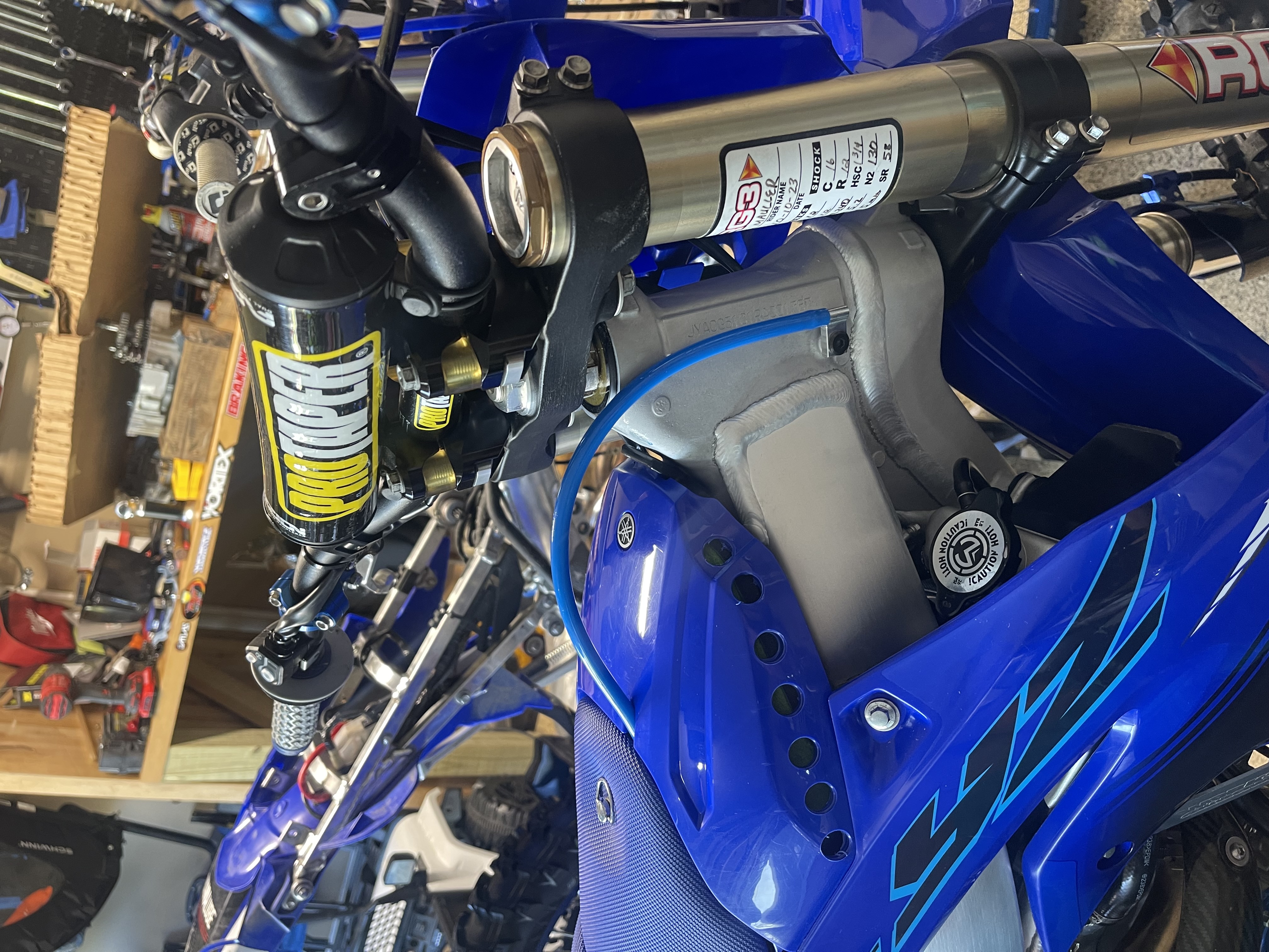

Think the cover came out pretty clean!
Is your gas cap hose our Teal hose? The Blue color looks like a lighter Blue Teal color.
Teal?
